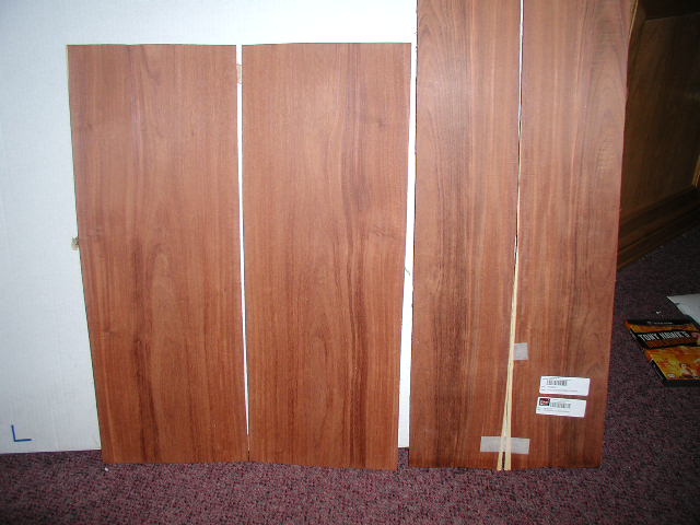

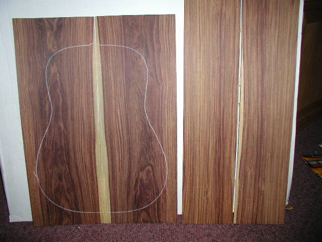

I went with the intent of picking through some of the Granadillo back and side sets that were on special, and did pick out two sets. I can't remember the name of the person helping me - I am just terrible with names. Sorry. When I asked what people thought was new and exciting, he brought out a stack of Macacauba. It's nice looking wood up close, has a nice ring to it. This one came home too:
Everything made it home before me.
In trying to find out more about this wood, I've hit a little bit of a wall. Google searching for Macawood generally leads to sites (including the USDA Forest Service) that equate Macawood, Macacauba and Granadillo, either as an unspecified member of Platymiscium, or as Platymiscium yuccatanum. Most of the pictures shown online do look more like the Granadillo we've been seeing from LMI or Hibdon (example follows)
It's clear that the wood LMI sells as Macacauba is something different from Granadillo. Anyone know what's going on here? (I'll send this to LMI as well, but it may catch one of the wood expert's eye here.)

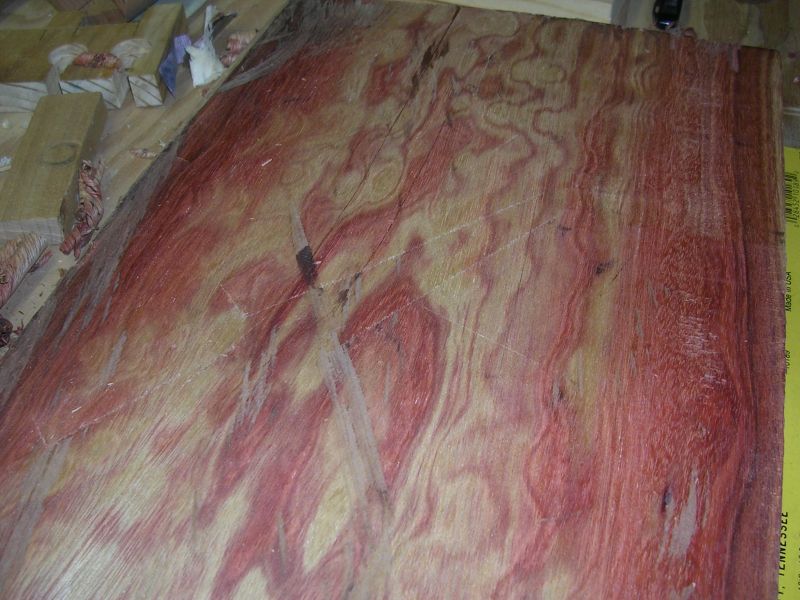

I'll add to the confusion... I was sold this piece as macawood also. Looking into it I found the same ambiguity as you have.

JT, I've read your post three times and I still can't figure out which photo is supposed to be granadillo and which one macacauba.
I think macacauba is popular in Virginia, though.

Ronn, that's some bizarre, wild looking stuff! You going to make something with that?
Where'd you get it, if you don't mind?

Howard - Top pic is Macacauba, bottom is Granadillo.

[QUOTE=Billy T] Ronn, that's some bizarre, wild looking stuff! You going to make something with that?
Where'd you get it, if you don't mind?[/QUOTE]
Billy. I will build with it someday... I got it as a plank off of eBay.

On the Platymiscium question, I have no doubt that two of them could differ as much as the two pictures above - look at Dalbergias after all. My question was more related to what you would get from a vendor if you asked for macawood or macacauba - it seemed that for most places you would get what we call Granadillo here.
Grant - When I tap the two sets shown above, it's pretty clear to me why the top set commands a higher price. It is like a good Dalbergia (BRW, Cocobola, ...) in terms of tap tone and feel. The other set is not quite like that.
